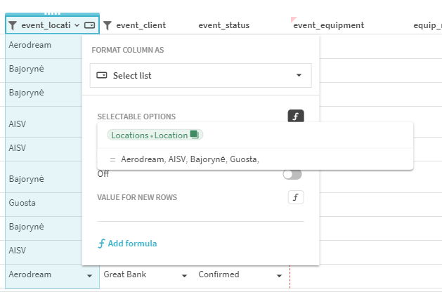

And one more question regarding lists. I see that it is possible to make Column in List format using values from another Table in two ways: by choosing List Format and referring Table in Filter part:
Or by choosing Lookup from Table option.
Is any of them better than the other for a particular reason? Like speed, use for other manipulations, etc?
